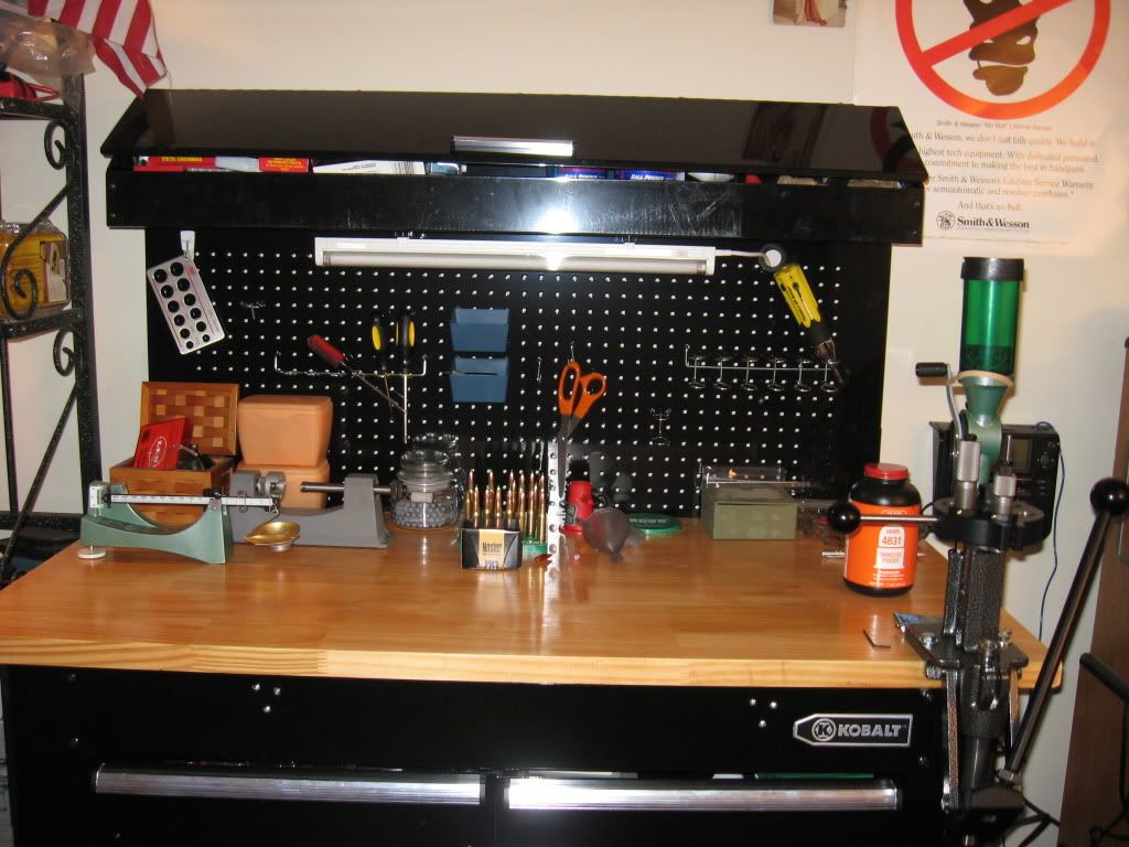

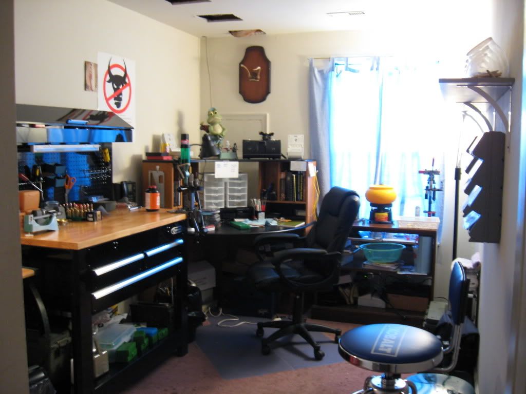

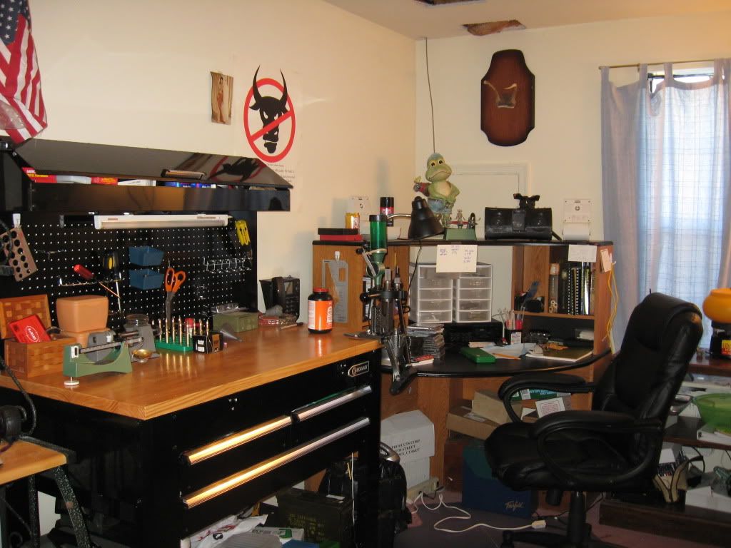

I've been thinking about it for a long time and happened to have some money available from a recent performance bonus at work. I went to an estate auction in Orange and picked up a lot of goodies - dies and bullets and a MEC shotshell loader (haven't gone there yet.) And then, it was Cabellas and me on a shopping flurry. The press is the Lyman turret and its working great. I think calling my first bullet a thousand dollar bullet is not too far off the mark, but I am setting up for a number of calibers (30 M1, 9mm, 45ACP, 38Special, 30-06, and 243 to start with). I was lucky enough to not buy *too* much that I don't need but I may have gone a little overboard. I reckon you have to pay for the education along with the components.
I'll try and display some pics of my workshop and my $1000 first bullet (30-06) which my wife promptly took from me and put it somewhere for a keepsake. Over the past couple of weeks, I have been experimenting with 30-06 loads between the min and max of the bullet/powder combination I am using. Very interesting! Early results are the lighter loads produce the tighter groups in my gun (Savage 110).
