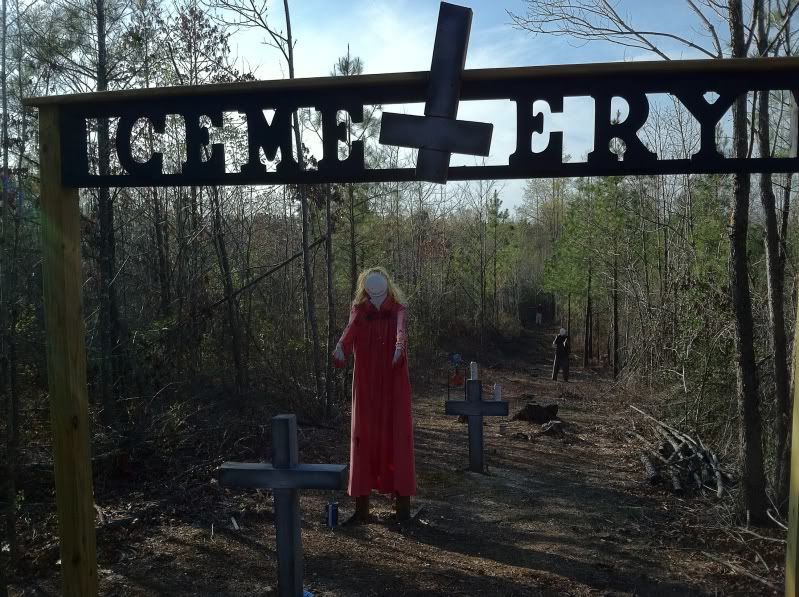

I'm went with a zombie theme for my personal range. I spread the targets out at 10, 25, 50 and 100 yards with the 100 yard zombie having a steel plate face. As long as you hear the "PING!" then you know you hit his brain pan. The range slopes downward toward very thick woods that spread about a mile deep. For the closest zombie being at 10 yards a head shot would put some shots at almost a treeline angle so I made an outhouse facade which hides a 50 gallon barrel of packed dirt placed directly behind head/chest placement. The zombies themselves have torsos made of 3/4" oak plywood that usually last about a month or so of casual shooting. I keep a stack of extra precut torsos on hand for replacement when the heads are basically just a web of toothpicks. For head targets I use 7" white paper plates so you can make out most bullet holes from 50 yards. We typically are only using 22's and mostly hanguns and pistol caliber carbines. The "tombstones" in the cemetery portion make a nice place to stack beer cans or spray cans etc.
My kids love it and my wife would much rather shoot here within walking distance of home than at a public range dealing with......well, the public.
