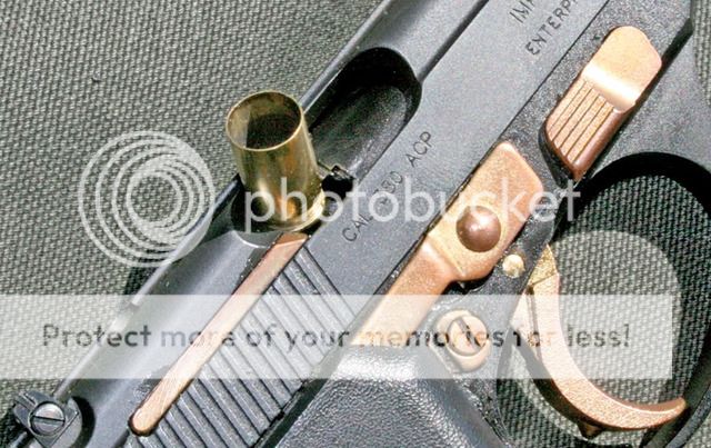

Stove-piping is when the slide has started travelling to the rear, the empty case is ejected, but the slide moves forward before the empty case has had time to clear, and the slide catches the empty case, pinning it upright and stopping the slide from returning to battery. It looks like a stove pipe sticking out of your firearm, thus the term "Stove-pipe".

Stovepipe means the spent casing doesn't fully eject and gets stuck in the eject port after the slide goes back forward. So the bullet end o the casing is hanging out and the primer end is still inside the eject port. It looks kind o like a stovepipe.
