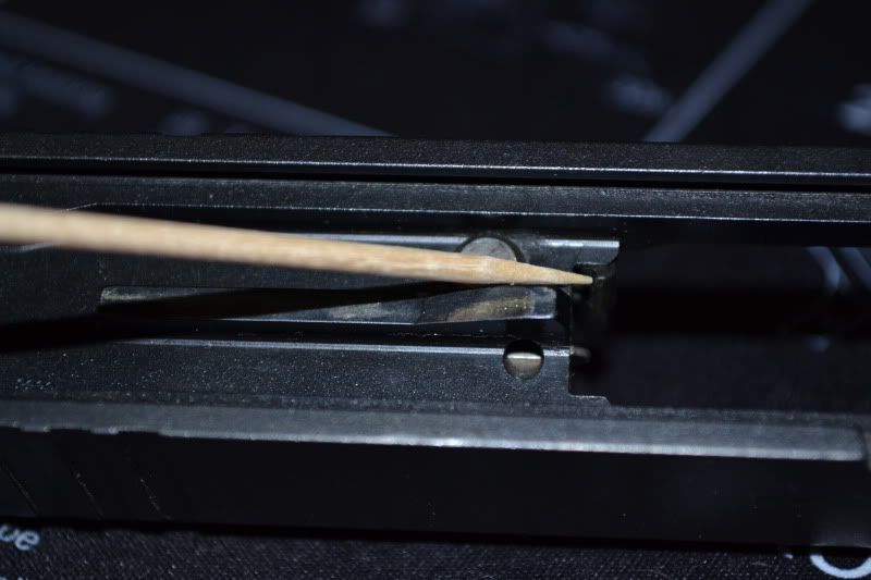

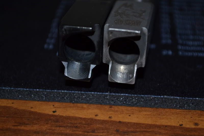

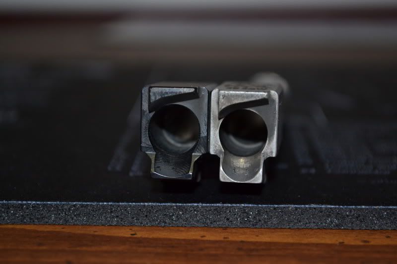

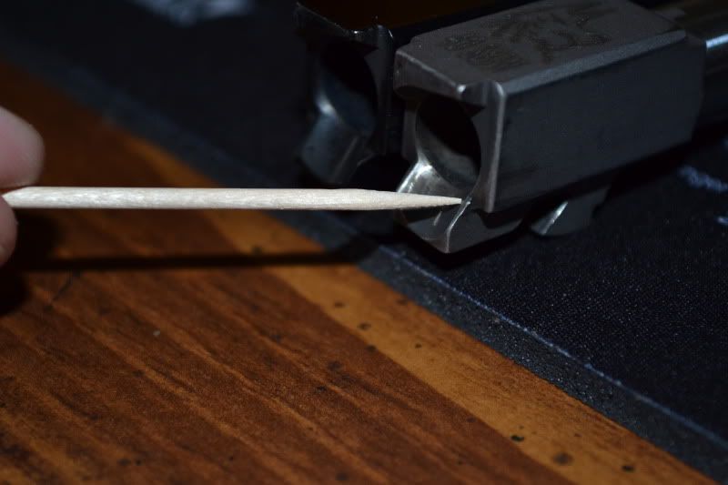

Just wanted to take a min to do a quick write up on my Glock 27 that I out fitted with a lone wolf 4" 2 port barrel. First trip to the range I was getting fail to extracts so just putting this out there for whoever is searching for info on their gun builds. Anyways as I stated I put a lone wolf barrel in a 27. I ran a 50 round course of fire and had about 5 fail to extracts. Tried different ammo, did function test with dummy rounds and was getting same results. Then I put in the Glock factory barrel and had zero malfunctions. I put the lone wolf barrel back in and ran it till i got a malfunction and started examining the gun before removing the brass. I noticed the extractor was sticking out a little with the slide in the "locked" position and the spent case still in the chamber. I cycled the slide and the casing still remained in the chamber, it was clear the extractor was not grabbing the rim of the casing. I broke the gun down for examination and found a contact point on the edge of the feed ramp. At this point the barrel was dirty with the exception of one little spot where the extractor was making contact with the feed ramp. There was also a corresponding mark on the extractor.
You can see the difference in the glock barrel and the LW barrel. The glock edges are "folded" like, as the LW aren't
You can see on the right side of the LW barrel the small contact spot from the extractor.
See the shiny spot from the metal on metal contact?
Corresponding mark on the extractor
One more comparing....
