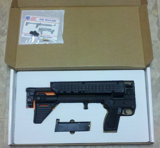

I have recently had the opportunity to test and evaluate (read "send a bunch of ammo downrange") a Kel-Tec Sub 2000 in 9mm Luger. Kel-Tec offers the Sub 2000 configured to use a variety¹ of readily available pistol magazines and they were kind enough to send me a test unit configured to use Glock 17 magazines.
When I picked it up at my local FFL, the gun was packed in a no-frills but form-fitted corrugated box and included a sight adjustment tool and a "key" to lock it in the folded position. Prominent on the lid of the box appears a large amount of American pride. In addition to the stylized American flag Kel-Tec logo, there are a series of smaller flag logos signifying American-Owned, -Made and -Parts - yeah, I like that.

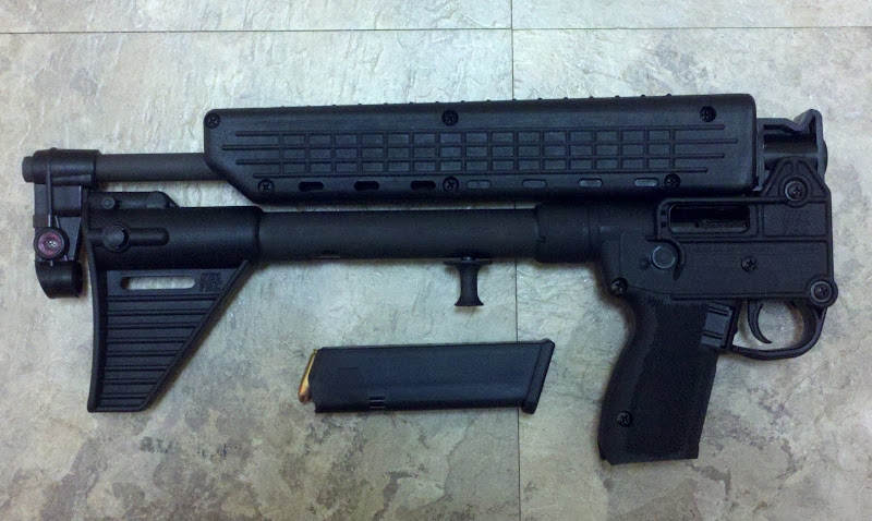

At 16.1" folded, the weapon is small enough to easily fit into a backpack, briefcase or laptop bag. (Or the available soft case from Keltec).

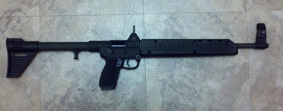

Spartan to the point of homeliness, this little ugly duckling comes into its own when you do what it was designed for - just shoot it. The cheek weld on the buffer tube leaves something to be desired (I believe a God' A Grip Customizable Cheek Pad ² would be a very nice addition) but "as-is" it is amazingly accurate.
The sights were off out of the box - but the groupings were tighter than this old man's eyes have a right to do. The sight adjustments are pretty straightforward - loosen a Phillips head screw with the supplied tool and then tweak the fluorescent blade up. Side-to-side sight adjustments are done with the hex end of the same tool by backing the locking pad out on one side and tightening by the same amount from the opposite side. Don't over tighten!
