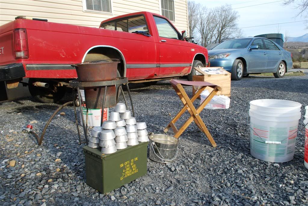

The crime scene

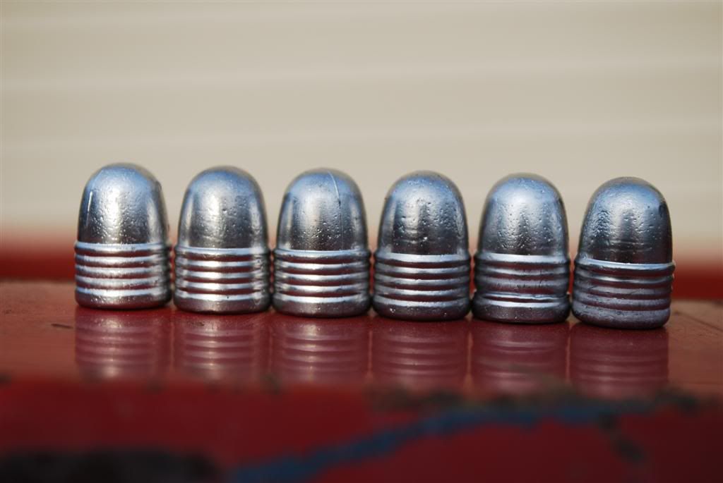

The goods
Image Image

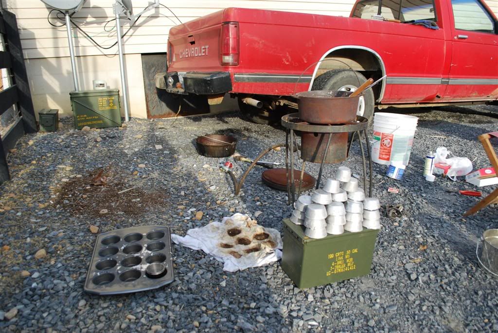

The bads
I do have a question for the veterans… on the “good” bullets that I cast today, there are what look like a lot of pores on the surface, once I start mixing tin, will those pores disappear? If not, what causes them and will they cause any issues?
I did not start out today with the intention to cast any bullets, it just kinda happened, so I wasn’t expecting quality results but honestly I’m surprised they turned out as good as they did. I can’t wait for next weekend when I start casting.

A little tin (not much) will help fill out your molds a little better. Also make sure the molds are clean. Btw, you dont have to wash the lead unless you really want too. Any crap will rise to the top as you flux the molten lead. Use a ladle to scoop it off the top...

Yeah I was just impatient today, I wasn't planning on actually casting any bullets, only ingots, but the urge hit and I poured a few bullets. The mold definately needs a good cleaning, and according to cast boolits the pores in the few I did cast will disappear.
